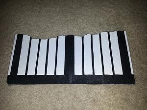

              This was a trial run on a broken piece to figure out the size and spacing for the threshold end of the runway. My stripes aren't quite straight in some places and aren't very even throughout, but it's a start. I'll probably make some adjustments when I start on my long piece of "runway."
              Also, I used the entire 12" width of this piece which would scale up to a 200' wide runway. However, I'm going to scale a 150' wide runway which will use the middle 9" of my piece. This will give me the ability to add some hobby grass around the edges.
              Should have some in progress pictures to post by tomorrow night. Hopefully, I'll have a finished project (runway) by the weekend.

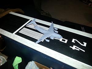

                        So this is the "end" of stage 1.
                        I have placed the 1:200 C-17 on the board to show proportion. Although my detailing is not 100% exact, the board and markings are essentially scaled to 1:200. The runway is a scaled 150 ft wide. For this width, the FAA guidelines say to have 12 threshold stripes at the end. I labeled the runway 24 R based on my experience at Marine Corps Air Station Miramar in California as that is one of their runways with which I have quite a bit of experience. If you look closely, you can see the narrow side stripes that run the length of the runway. I tried to be as precise as possible with modeling a precision approach runway.
                        Stage 2 will be to add touchdown stripes just ahead of the first centerline stripe. I'll also add a few more centerline stripes towards the upper end. I'm also going to add the chevron-shaped blast markings just behind the threshold of the runway. Also, I'll glue some model grass to the outside edges.
                        That will conclude this piece, but I plan on making a small taxiway piece that will join up with this.
                        More to come!
                        Never trust a helicopter under 50! Phrogs Phorever!

                          Also, there's some touchup of the base layer black that I'll have to do when it's all said and done. And like was posted earlier, I'll clear coat the paint with a flat layer to protect everything as much as possible.
